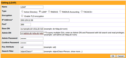

Hi, I am a technical IT and I am trying to configure LDAP auth in RUCKUS Wireless, but without success.
I configure the ruckus wireless with this datas:
I too used this same datas in other applications with success. But in ruckus wireless the test of authentication fail.
I noticed in the log of LDAP that the ruckus software do many requests. In the first it find:
[email protected],ou=people,dc=ufca,dc=edu,dc=br
as a result using this filter:
(&([email protected])(objectClass=*))
But after, in a second request it find a error 32 that indicates the target object cannot be found. Using this big filter:
(|([email protected])([email protected],ou=people,dc=ufca,dc=edu,dc=br)([email protected],ou=people,dc=ufca,dc=edu,dc=br)([email protected],ou=people,dc=ufca,dc=edu,dc=br))
Happens that this attributes memberUid, uniqueMember and member does not exist in base LDAP.
In short, because of that the login fail.
I am searching for a solution, who can helpme?
