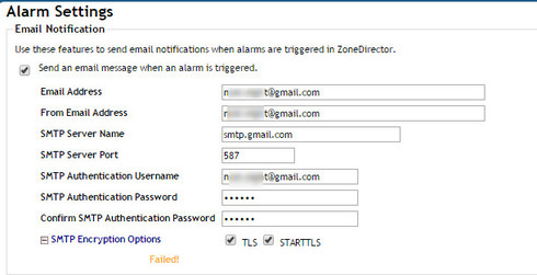

Need help! I am setting up an email notification on ZD3000 (ver 9.5) but always "Failed!". I've tried all my email accounts gmail, yahoo mail and followed some steps but got no luck.
I associated the IP Address of the ZD to the private IP network that can go to the internet but failures always there.
I also add the DNS of 4.2.2.2 and also 8.8.8.8 to make sure that the DNS were not affecting the failures.
Please see my settings below:

Hi try SSL on port 465

If I recall correctly, you have to enable and confirm mail being sent from a non-gmail application.  I am using the same settings as you have without an issue.
There were issues with GMail in some of the past versions.  I am running 9.12.

Well thanks for your help. I managed to try first on my yahoo mail and I received a notification that I need to lower the security settings to give way for the application to send emails. It now works fine and I also tried it using gmail now and it was successful.
