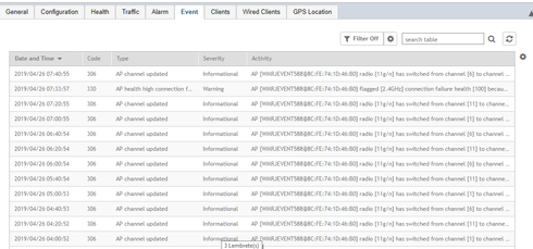

2 - Constant channel change (Background Scanning) set to 600s (10 minutes).

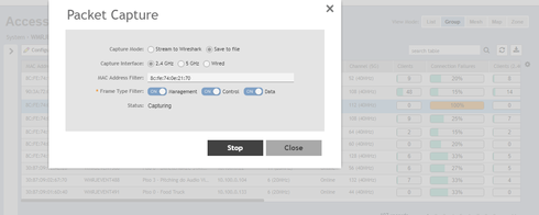

4 - The AP packet capture file came empty (tried 3 times, and collected in times apart), collection for approximately 15 minutes.

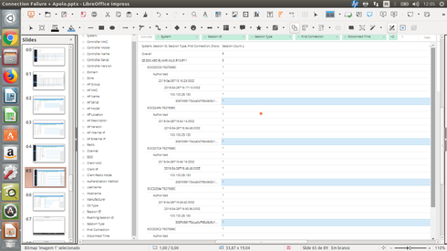

6 - The same user of item 5, has 5 sessions in SCI. I need to know what the metric is, because in the view of the controller this user is unique, but why in history does he report with 109 entries in the SZ300, and "only" 5 sessions in SCI? What is being evaluated? This scenario is with all my clients, and the numbers are dissenting.

So much going on here. so many questions. on point 4, if you leave the mac address out of the filter, do you then receive a capture file?
52 Messages
760 Points
Hi, Andrew
I did not try, but I do not think so. Well it asks for the mac of the ap that you need to collect, however, the file comes with 1KB (empty).
232 Messages
4K Points
no, that is a filter. you should leave that blank. if you do, you should get all AP traffic! Try it!

But what I really need to look at is all the AP traffic. in both frequencies
Employee
36 Messages
868 Points
MAC address filter is used to filter for a particular client MAC you want to look for, it is not the AP mac address.
You also need to setup wireshark to receive the pcap from your particular AP
create a new remote interface where the host is your AP IP addr.
Also, wireshark needs to be version 2.6.7 or earlier.
Take a look here
https://support.ruckuswireless.com/articles/000002002
https://support.ruckuswireless.com/articles/000002607

For #2 - many factors can contribute to this, best to open a TAC case to see what's going on under the hood. BG will change channels depending on a multitude of factors and scan intervals

For #6 - Could be related to disconnection/connection so different session starts/stops and times.
