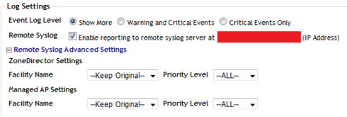

    We have a ZD1106 (v. 9.9.0.0 build 216) with various access point ZoneFlex 7372, I configured the "Log Setting" on ZD so that I could receive routing traffic, as IP / Port Source, IP / Port Destination, MAC address, AP MAC address, however, I didn't receive it, just other logs. Is it works on this firmware as well as the other or just version 10.2?

Hi Syamantak,
I don't why, but some article I can't read, anyway, is there any possibility of using "Client Traffic Logging" in the available firmware?
Because I need this info, as IP / Port Source, IP / Port Destination, MAC address, AP MAC address in to the log.

For your help, I am adding two screenshots of the article here. Please refer and confirm if it solves your problem.

Hi Sanjay,
 Seems that I received some logs about this, as you can see below, but I need more than that, what I need is "IP/Port Source, IP/Port Destination" from those sites visited for the user, Is it possible ?
   stamgr_send_log_v4():operation=add;seq=13;sta_ip=IP LAN;sta_mac=MAC ADDRESS;zd/ap=MAC ADDRESS/MAC ADDRESS;sta_ostype=Android;sta_name=USER;stamgr_handle_admin_auth_sta_request
