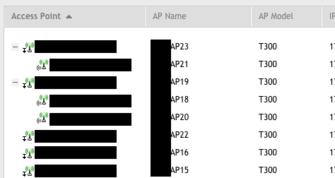

Recently we've implemented a public WiFi network which utilizes smart-meshing for a total of 4 out of 8 APs. Today we drove back to the site after all the installation work has been done last week. We noticed that a few APs don't seem to be broadcasting. This is also visible in the in the vSZ, although, not that clearly.
Below is the partial meshing setup for the network. AP17 is meshed with AP13 and is working absolutely fine, but AP21, AP19, AP20 and AP18 are not broadcasting.

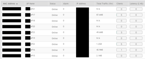

In the below screenshot the Total Traffic shows N/A. This already indicates to me the AP is not broadcasting. Also there is no channel on 2.4GHz and when checking the general AP details, the WLAN list is empty on the aforementioned APs.
