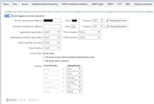

We are running into an issue on our vSZ (v5.1.0.0.496) with the clientAuthorization and clientJoin syslogs. Neither of these syslogs contain the clientIP field, which is a problem for customers with security appliances that depend on these syslogs to tie usernames to wireless clients. Strangely, the clientDisconnect syslog does include the clientIP field.
Is there a way to enable this feature? ZoneDirector syslogs include a field for "sta_ip", which is what we've been using in the past (see THIS thread for context on ZD syslogs in this scenario). The vSZ syslogs are in a completely different format, which is fine, but they are missing this critical information. Here is my vSZ configuration for reference:

We are receiving the clientJoin syslogs with the current configuration, aren't those sent as part of the "Event Facility" and "Event Filter" settings? I intentionally set the "Application", "Administrator", and "Other" settings to the highest level in order to avoid overrunning our syslog server. Does one of these need to be set to Info in order for the clientIP field to appear?

The SmartZone Controller has the following settings,
System > General Settings > Syslog
Enable Syslog
Primary Syslog: Palo Alto Management interface IP(the default for user auth)
Port: 514
Protocol: UDP
Event Filter: All Events above a severity
Event Filter Severity: Informational
