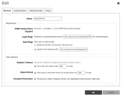

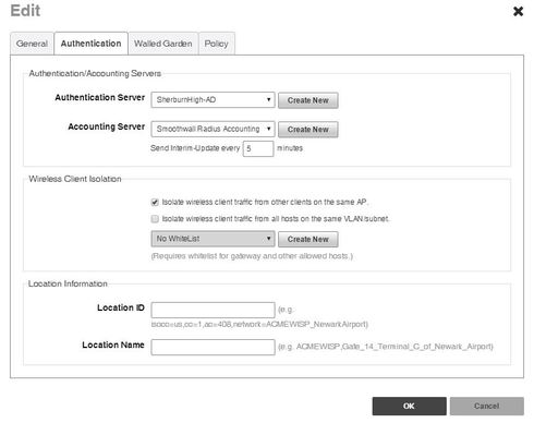

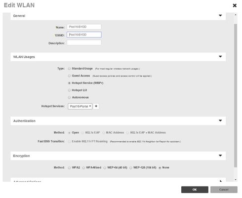

Here are screen shots from my ZD1200:

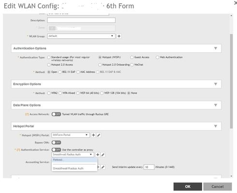

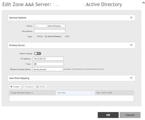

and here are screen shots from my vsZ which will not allow me to choose the AD AAA server which i've configured
There is no way i can replicate my settings from the ZD1200 to the vsZ therefore i'm feeling stuck with the zd1200.

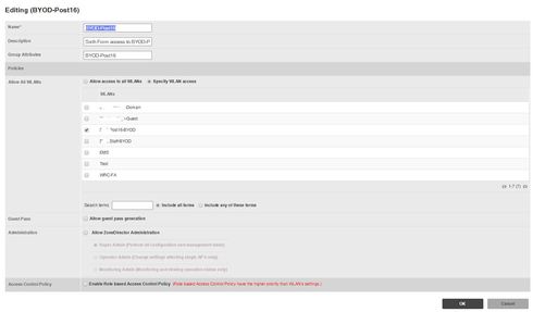

Here are my ROLES configuration on the ZD1200 which can be found in Serivces and Profiles > ROLES.
Where on earth is this in the vsZ as this stops users from accessing SSIDs that they shouldn't have access to?

I'll try to help here in phases as I can test/recreate scenarios.  For the WISPr Authentication Server, it looks like it actually creates it under the Proxy (SZ Authenticator) sub menu for Authentication servers.  If you created it under Non-Proxy (AP Authenticator) menu, it will not show up in the dropdown.  The simplest solution here would be to simply create the Auth server from within the WLAN creation workflow (by hitting the + button beside the dropdown menu).
