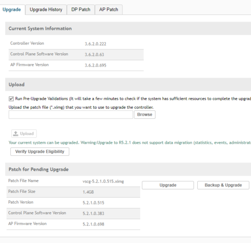

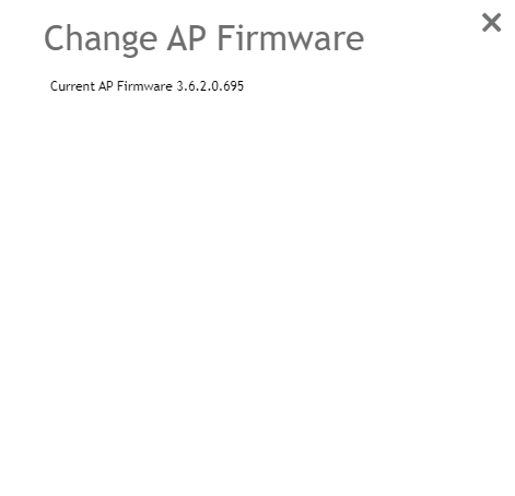

Hello, I have uploaded new AP firmware to my Smartzone. I am now going to the zone and selecting 'Change AP firmware'. However I only receive this blank popup page with no option to select the firmware to upgrade to. Am I missing something ? n.b. I have tried multiple different web browsers in case it was a GUI rendering problem but see the same result.

If you are mentioning about the 5.2 version upgrade, then you first need to upgrade the Controller and then the AP firmware will appear.

It seems you only uploaded the new controller firmware file to v/SZ but not yet hit "Upgrade" or "Backup & Upgrade".
Hit the "Upgrade" or "Backup & upgrade"(recommended) button and complete the controller firmware upgrade. Doing so will also upgrade AP firmware and then you can go to AP Zone >> More >> Change firmware and you should be able to see 5.2.1.0.698 AP version in the available AP firmware.
