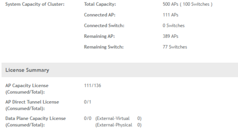

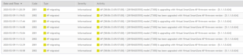

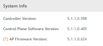

We are trying to manage a T300 AP with a vSZ but it doesn't appear in the controller.  In events we can see the attached logs. we attach other info about AP and controller.

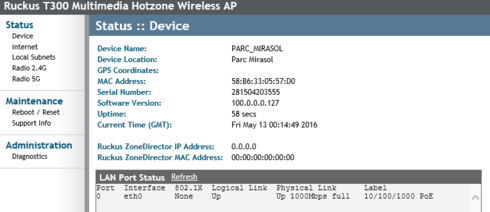

We also got this error :
May 13 00:16:31 PARC_MIRASOL daemon.notice Firmware Daemon[7948]: working|looking up control server IPMay 13 00:16:31 PARC_MIRASOL daemon.notice Firmware Daemon[7948]: working|reading control file
May 13 00:16:31 PARC_MIRASOL daemon.notice Firmware Daemon[7948]: working|reading firmware file header
May 13 00:16:31 PARC_MIRASOL daemon.notice Firmware Daemon[7948]: failed|firmware size not as specified in control file
May 13 00:16:31 PARC_MIRASOL local2.err syslog: Firmware update error(-1)

Hello,
we've just solved this issue by updating firmware to 100.0.0.0.2005.
