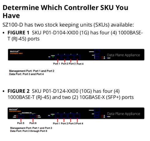

Hi everybody,
Have a question about the SZ100-D ports, that I'm struggling to find any documentation on. In the quick start guide they are just labelled as 1-2 being management, and 3-6 being data (or 3-4 if you don't have the SFP+ ports).
So my question is, how do these ports behave if they are both connected? Are they doing some kind of failover, or aggregation?
As far as I can see in the configuration, you don't set anything by specific port, just management or data interfaces.
Thanks,
Chris.

For the SZ104-D, ports 1 and 2 are reserved for Management and can be bonded and ports 3 and 4 are reserved for Data and are bridged. All are 1GbE interfaces.
For the SZ124-D, ports 1 and 2 are reserved for management and can be bonded. Ports 3 and 4 are Data and 1GbE. Ports 5 and 6 are Data and are 10GbE. Ports can be bridged.

Ports 1 and 2:
These ports are for management, as advised, but they do not run, and cannot be configured, in a bonded mode. They run in an active/passive configuration by default. Upon boot if both interfaces are connected, whichever one is detected first by the DataPlane will become the active interface, and the other will be in standby mode. If the active link is disconnected, the other will then become active. These ports share the same network bridge, and therefore share the IP address configured on the DataPlane for the management interface. There is no special port configuration (LAG) required on the switch end.
Ports 3 to 6 (depending on model):
These ports are for data, as advised, and are bound to the same network bridge by default, and so share the IP address configured on the DataPlane for the data interface. Unlike ports 1 and 2, they are both active at the same time, but not in a LAG. So again there is no special port configuration required on the switch end.
