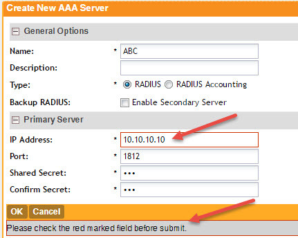

How can I configure IPv4 AAA in a zone using IPV6?
I have zones using IPv6 for AP management but wanted to create AAA using IPV4. I am however not able to as it is only requesting for an IPV6 address. Is there a work around to this? It is extremely important to have the AAA working on IPV4 for external analytics and captive portal functionality.

Hi Anthony,
   Assuming you have a vSZ-H, you need to have enabled both IPv4 and IPv6 in the initial
startup wizard.  If you have both protocols enabled, you can have IPv6 AP Mgt, and IPv4
AAA servers (should be an option).
