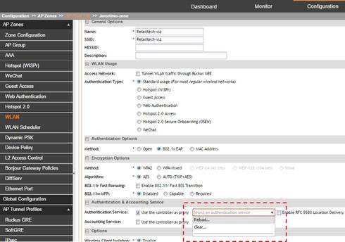

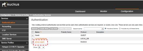

I configured AAA server(Configuration>>Services>>Authentication) as proxy-mode.
But I can't find this under wlan setting for 802.1x.
How does it configure?
Plz let me know about it.

First under AAA you need to add the radius server, then you can select it in the WLAN menu you mentioned.

Sorry, it's VSZ-H.
In the case of  VSZ-H, plz let me know about it.

I could do it, basically it was a mistake, you have to define your Radius servers under config-system-services-AAA
once it done, you must assign one or more for every non-3gpp auth-method for "No match" and "unspecified" as well (might be you should use more).
Don't forget to set up appropriately the WLAN settings as well (Called-STD ID and other paramaters) and deploy the appropriately settings for free-radius or NPS as well. It works, I can confirm
