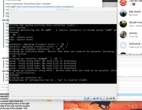

hello everybody,
first of all, I show you what I did setup.
ISO file: vscg-5.1.0.0.496.ova
VM: Virtual Box version 5.2.28 r130011 (Qt5.6.3)
RAM: 5G
CPU: 2 cores.
Network Interface: keep only one NIC [Attached to Bridged Adapter, Name en0: Wi-Fi (AirPort)]
I start this VM, then see the error:
Bringing up interface bond: Device eth* does not seem to be present, delaying initialization.
Bringing up interface ifcfg-eth*: Device eth* does not seem to be present, delaying initialization.
[FAILED]
Bringing up interface br:
Determining IP information for br..."up" is invalid lladdr.
then the login terminar appears, I can login with admin and password, then enable to setup. I choose both of manual & dynamic, but they could not get the IP Address. I see they are related to the error on booting screen. But, I don't know any command to fix it for now on vSZ operating system.
Could you please help me?
Thank you so much!

Multiple issues. VirtualBox Is not a supported hypervisor. Also you're very short on ram. You need at least 13G of ram.
You should check the type of virtual nic you're adding

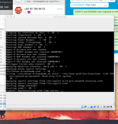

unfortunately, my vSZ VM could not start after finished the configuration on web interface. Although it informs that I can login to https://10.10.1.224/...
based on current system configuration, I set 5G ram and is that root cause? the vSZ Essential didn't have enough resource to work?
please let me know what should I do? thank you so much bro!

You need at least 13G of ram. Open a Google account and get their Google cloud credit and deploy vsz there for one month for free. Or find a bigger server locally
