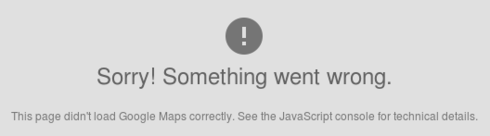

If I use https://ruckus-vsz.curric.lan:8443 instead (resolves to the same host), it doesn't; instead I get a brief flash of the working Maps screen, quickly replaced by

Oops! Something went wrong. This page didn't load Google Maps correctly. See the JavaScript console for technical details.
