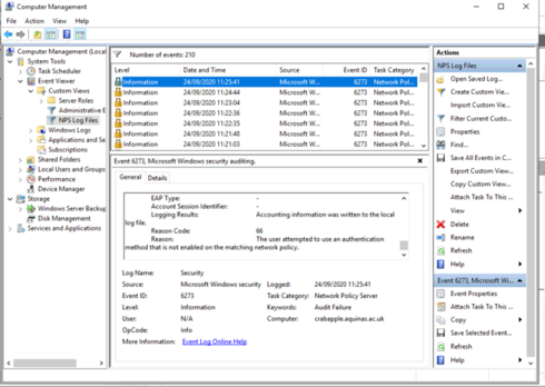

We have our 802.1x RADIUS Server configured to use an NPS Server.
When we test the RADIUS Server from the Smart Zone Controller or via an 802.11x enabled SSID it fails.
In the logs on the NPS Server we see
Error Code: 66
Reason Code: The user attempted to use an authentication method that is not enabled on the matching network policy

Hi Stephen,
Could you also attach the screenshots from the NPS policy settings.
Seems auth methods are not correctly configured in the NPS policy.

Thanks for the reply. I have followed the setup gudie for NPS 802.1x for VLAN assignment.
NPS Settings are:
*Same error seen whichever way we ave the EAP Types
*here we wish to return the VLAN 40 tag to SmartZone

Hi Stephen,
Could you select EAP Types and make sure correct certificate is mapped?
Also enable "Wireless Other" in NAS Port type.
Post making above changes if you are still facing issues, please open a support case and they will assist you.

PEAP Cert Details:
Changes applied:
Same Issue on NPS:
Employee
633 Messages
10.3K Points
Please open a support case from the below link and support team will help you to check the issue further.
https://support.ruckuswireless.com/cases/new

2 months ago
Error was fixed by changing the Condition on the Connection Request Policy to Day and Time Restrictions (allow all)
