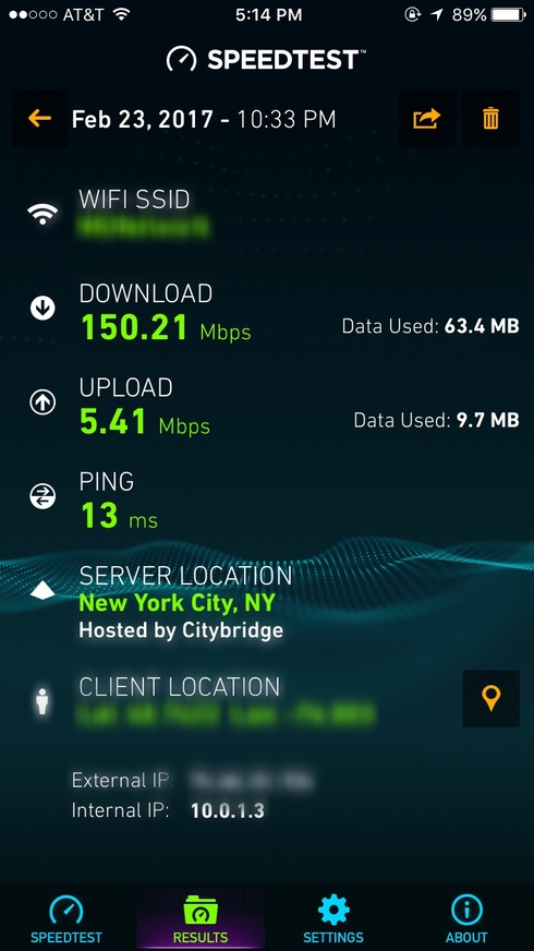

I setup an R310 in gateway/router mode and noticed that I am limited to ~150mbps download and ~5mbps upload. I subscribe to and consistently get 200mbps download and 30mbps upload speeds otherwise. Is this a known limitation when the access point is in gateway mode?

The same R310 when used as a standalone AP but also eero or Apple extreme. These are my speeds when I am not using the R310 in gateway mode. I ran multiple speed tests when in gateway mode and it was strictly adhering to ~150/5.
