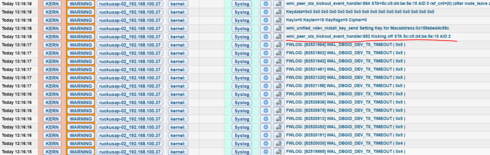

In my syslog server show me some message such as  "wmi_peer_sta_kickout_event_handler:852 Kicking off STA 5c:c5:d4:be:5e:15 AID 2".
And I can see many messages like below.
FWLOG: [82521964] WAL_DBGID_DEV_TX_TIMEOUT ( 0x5 )
Does anyone know about this massage?

Please look closely at your screen shot, and thanks for including.
The client moved off of this AP (after node leave ssid), which subsequently sent the last "kicking off STA" message
as it cleans out it's Client Associated ID (AID) table.
This is not a problem/bad thing.  Is this client having any kind of problem?

Thank you for letting me know the meaning of the message I was wondering.
The device have some delay at packet fowarding for about 2-3 sec.
And many roaming was happened.
Thanks for answer.
