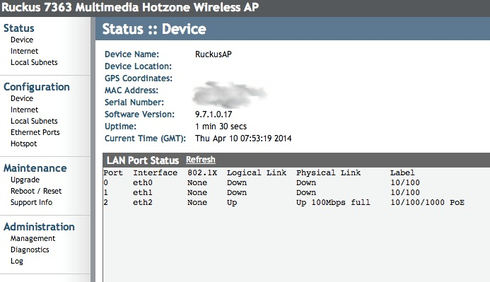

I recently updated our ZF 7363 AP with the newest hardware. However, upon restart, I currently have no options for selecting the wireless Radio's on the left hand side menu. I have tried to downgrade firmware and it all stays the same. Can someone help with this problem? It s a standalone AP. Here is a picture of what i see.

I did hard-reset the AP 3-4 times in a row with unplugging it a few times and it finally was restored to normal. It is in a working environment now with no problems. Thank you.
