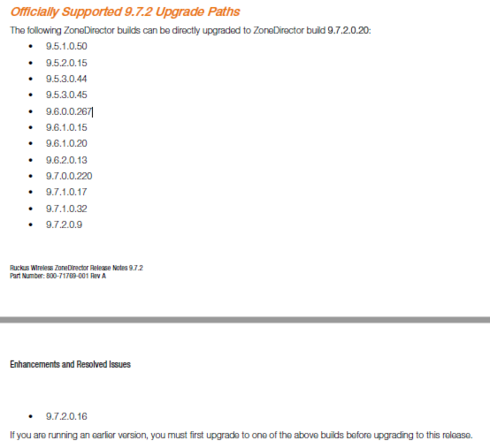

Upgrade the ZD1100 9.7.2.0.32 with Zone Flex 7982 this version from 9.7.1.0.17
I try to upgrade to 9.7.2.0.32 from 9.7.1.0.17, the ZD1100 controller can upgrade to 9.7.2.0.32, but the Zone Flex 7982 was failure to upgrade to 9.7.2.0.32.
Then, I prepare to following the upgrade path.
When I find out the 9.7 release version
I cannot find the 9.7.2.0.16 from official supported website
https://support.ruckuswireless.com/products/29-zonedirector-1100#firmwares
So, If I try to upgrade to 9.7.2.0.32 again, I need to download 9.7.2.0.16 version?
Or I just upgrade to 9.7.2.0.9, it can upgrade to 9.7.2.0.32?

you don't need to upgrade the ZF, the ZoneFlex will get updated from the ZoneDirector.
you don't have to install a version in between, all listed versions can be upgraded in one step.
