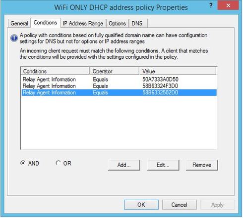

I have been having issues lately running out of ip addresses on my Windows Server 2012R2 DC because the wireless mobile devices are just too numerous. I would like to get all of the wireless traffic onto it's own VLAN and use Option 82 so that my DHCP server will hand out IP Addresses to the clients from a pool created specifically for the new VLAN. My current network is as follows.
VLAN 1 Default: 192.168.2.x/24
VLAN 10 Voice VLAN 10.10.10.x/24 (this is for my VoIP Phones/Devices
VLAN 20 WLAN 10.10.20.x/24 (I created this VLAN specifically to use with the wireless network)
I have HP Procurve L3 switches that I have created all the VLAN's on.
I also have a Sonicwall firewall UTP that I created a virtual interface on using 10.10.20.251 as the ip address VLAN 20 and bound that to the LAN interface.
I attempted to read through the admin guide and configure the Zone Director 1100 but just could not get any further for some reason as I am not sure exactly what the settings on the ZD1100 should be or what ports need to be tagged/untagged on the switches in order for this all to function correctly? Would someone be willing to walk me through this a little deeper so that I can get this working? I have setup the DHCP scope policy to use Relay Agent Information and enumerated the MAC Addresses of the AP's should I also enumerate the ZD1100 MAc Address too? Thank you for any and all assistance.

As for your other DHCP question, when you use VLANS and the ip helper-address command together, DHCP is smart enough to know what address pool to use. I use VLANS in almost 99% of all environments and have never had to use option 82.
