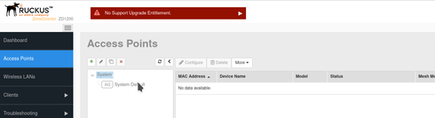

No AP is showing up in the Access Points tab:
I can access both AP's and the ZD from my laptop. As explained, they are both connected through the same switch. Even though, I cannot get:
nr 2 Access Point to use discovery
Nr 1 access point to be managed/connected to the ZD
