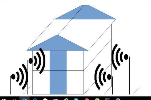

IMPLEMENTING WIFI COVERAGE ON APARTEMENTS BUILDING (TOTAL: 7 BUILDING).
IMPLEMENTING WIFI COVERAGE ON APARTEMENTS BUILDING (TOTAL: 7 BUILDING). I have 7 building in total and each building has 18 rooms i need to implement an outdoor Solution so that we can ensure that WIFI Coverage Signals is more good in terms of Quality . Our Building are concrete but they have big mirror for transparent . Can you please advise me the suitable solution and less cost effective solution that will cover each building.

Thanks for sharing. Actually we already installed Zoneflex R600 in each building like for instance each block has 3 Floor; Down & First & Second Floor and on the down floor : 8 room with 2 AP of Ruckus R600 and on First floor; 2 AP with Ruckus R600 , 2nd Floor; 1 AP R600. So the issues happen the room which are at the corner they don't get good WIFI Signal. its only the rooms which are at the center they get good signals. On this blocks we don't have data points. Its only we have MDF Cabinet that we have run the Cat 6 cable on ceiling up to the AP where they are mounted on the walls.  So am finding a suitable alternatives that i can covered at least those rooms with limited signals and improved also Good signals since the staffs we will be streaming TV Channels with our service provider. Am in Seychelles. The above project is only in Staff side giving them flexibility to relax since we are on remote island. Our MDF has 8 POE 2530 HP Switch so i have 2 ports left or upgrade to 24 port POE 2530 switch on 5 blocks that have 8 POE SWITCH.

Adding to that, Each block total number of rooms is: 16; (Down floor:8 room(2AP R600 installed) & First  Floor:8 room 2 AP R600 installed; Second Floor: 2 room ; 1 AP R600 ) Those rooms are installed with AP each floor mounted on the walls. Our blocks is concrete but we have mirrors on the back side and front side . So i was thinking for a reasonable cost effective solution that will be good for my staffs since we will be doing streaming on TV Channels. And the total number of staffs is : 300 as baseline so the concurrent streaming connection we cans set baseline like: 250 minimum.

The Building where built 7 years back and the requirement was sufficient on those early days. Now the buildings are serving more staffs and this 7 blocks can accommodate up to 310 staffs.So what am doing is upgrade the WIFI Facility to be available in all the Blocks.The site was done and our WIFI Devices are working fine, My objective is to make sure the rooms which don't get signals need to get signals. The solution was very easy if each rooms has data point it was quick and fast implementation. But the buildings doesn't have data points. So i need a layout suggestion on how we can implements an effective solution weather is an outdoor & Indoor solution by running CAT6 Cable into the MDF Cabinet which are installed to each block and to the UNIT.  Conclude, I need a  solution design that is good to implement by requirement.  Your solution will be help fully.
