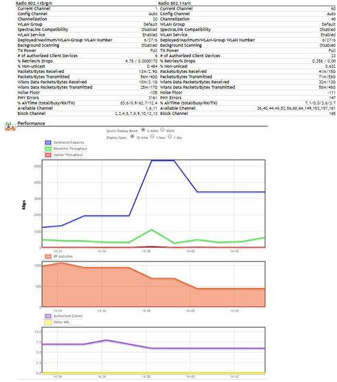

One of my ZF7372 has high RF Pollution and users always has bad connections. I would like to find out will high RF Pollution affect wifi performance directly? Does re-locate AP helps or any fix?
Screenshot below which value shows the AP has bad performance that I need to aware/fix?

This may not work, it's just a guess, but my first thought when you mentioned high RF pollution was, why not change channels? Then I looked at your screenshot and I see you've disabled Background Scanning and allowed only channels 1,6,11.
ZoneDirector and Ruckus APs use Background Scanning to try to find a better channel, constantly. If Channel 1 is polluted, they will try to find a better channel. You may have forced the AP to use a bad channel and disabled the feature that allows it to try to find a better one.
My suggestion is allow all the channels on both bands, enable Background Scanning, and see if it will find a better channel by itself.
You also have 6 WLANs deployed on this AP. That's a lot. If there's any way to reduce the number of WLANs deployed on that AP, maybe try to reduce them. We say 8 WLANs is the recommended max otherwise performance will suffer. 6 WLANs is getting pretty close... you can use WLAN groups to put some WLANs on some APs and others on other APs so there's not so many WLANs on channel 1.

Hi Jay, yes we do have multiple WLAN in our environment. After a few checking I noticed that there are 2 WLANs have background scanning set to off. As suggested, background scanning is on all AP now, will see if this really help.
Will consider decrease the number of WLAN too.

Along with the channels, I would suggest to reduce/increase the tx power based on the coverage overlap between the adjacent APs.
I think a site survey would be recommended here.

Site survey was done before deploying APs, but our users encountered bad performance on certain location recently.

Perhaps new equipment installed near that location.  Would be good to enable background scanning, run ChannelFly for a while, then turn it off and keep last channels...?
