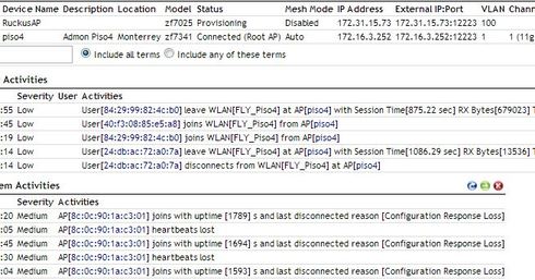

Configuration Response Loss. AP and Zone Director on different subnet.
I am installing a 7025 on a different subnet of Zone Director. The Layer 3 connectivity is Ok. No firewall. The AP discovers the Zone Director. When the Zone Director starts provisioning of AP, the log send this message: AP[xxx] joins with uptime [1399] s and last disconnected reason [Configuration Response Loss]. The AP Status keeps on Provisioning. Any idea?
