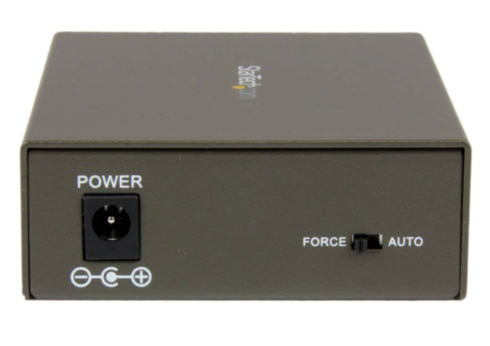

This is due, the access switch down for too long. even after troubleshoot the cable, switch still cannot up normally. The switch can power up but cannot be detected in the network. Last option we try to change the mode at fiber converter from auto to force.

If U use 1 MC (not a pair), U should check the SPEED & DUPLEX at both the points - on the electrical switch port & on the optical core port. The SPEED & DUPLEX on both points must be UP in THE SAME. Here is 1000 BASE TX & 1000 BASE LX.
Check UTP - it MUST be use all the 4 pairs & correct RJ-45 montage (8P8C gigabyte).
U d avoid to use FORCE button, -  it isnt good for the L2 logical work of GE ports (MDI/MDIX).
