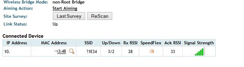

Question 2: when I logon onto the AP's portal (http) , on the main page, I see a destinction between Rx RSSI and ACK RSSI, what am I looking at and is this a good way to monitor the bridge quelity?

Dennis, you do have the correct MIBs. The return values correlate to the WebUI
Rx and Ack RSSI, indicating signal strength in both directions. Values over 25
indicate satisfactory signal strength to maintain the link, which you can measure
or graph to monitor link quality.

so the OID-returned value, is that the Rx RSSI or ACK RSSI?
