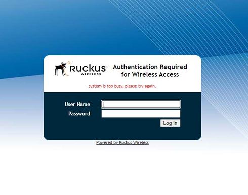

Ruckus Smartzone Wireless LAN w/ AD authentication Issue
I have configured a WLAN in Smartzone with AD authentication. After connecting to the SSID and entering domain credentials in the WebAuth Portal. It fails with the following error "system is too busy"
Do I lack some configuration on my AD side or Smartzone? I tested AD authentication prior to this and was successful.

3- WLAN type, encryption type and authentication type? Please see image below.

I can see that you are using AP as authenticator, means AP will send the auth request to AD server.
Could you make sure APs has reachability to AD server.
Also run troubleshoot utility in vSZ GUI and connect the test client. This will help us to understand at what point connection is failing.

Hi Syamantak,
Yes, I can see that the Portal points to the APs IP address. Can we also use SZ for the web authentication portal? We have tested AD authentication in Smartzone and was successful. I don't know why it shows this error after entering credentials on portal.

No, portal is hosted from AP so you cannot change that but you can use authentication part proxied to SZ. Means authentication request will be sendout from SZ to AD server, rather than APs.
Please note that authentication should work irrespective of proxy or non-proxy, so I would suggest you open a case with support, if you can find a fix by your own.
