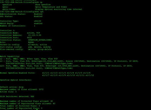

I would like to connect my Brocade ICX 7250-48 (SW-version: 08.0.80cT213​) to the Lumina Flow Manager (version 7.3.0).
The SDN controller is already installed and the connection between my laptop and the controller is established too. You can see the output of the Brocade CLI command "show openflow" below:
Openflow is enabled on ports 1/1/1 to 1/1/12 in normal mode (with the CLI command: openflow enable layer23).
They are also untagged in vlan 156.

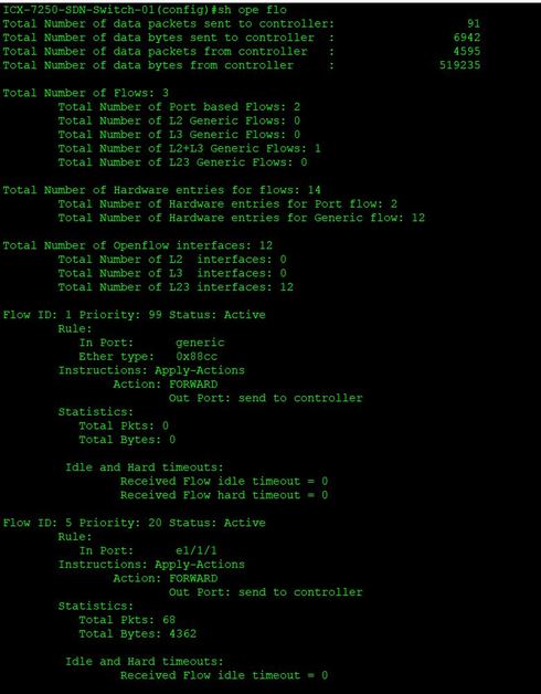

1) After creating the flows, when i check the configuration of flows on flow manager, their output port was automatically set to "SDN controller", but why? (because of this they are not able to ping each other)
2) Why hosts are not detected automatically by the SDN controller? (I mean i can not see pc1 and pc2 on the topology view of the SDN controller, but i can see the Brocade switch)
You can see also the output of Brocade CLI command "show openflow flow" below.
I would be very greateful , if you could help me with this.

Hi Mohammad - I believe we'll need bidirectional flows from port 1/1/1 to 1/1/2, then from 1/1/2 to 1/1/1 for each type of traffic. Additionally, we'll also need to allow ARP traffic to pass both way as well. With out ARP getting resolved, IP host to host traffic won't work. ARP is ethertype=0x0806, while regular IPv4 traffic (ethertype=0x800), so permit IP any any will not allow ARP.
Thanks,
