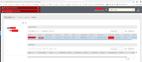

HELP "Cluster is out of service" again
Our client has encountered this issue again
this issue occurred a month ago also prior to that and it happen again yesterday
what our client does is restart the VM to get it back on service
they already migrated this VM to a new server SANGFOR HCI
but the issue still persist
Please see attached image:
any idea what's causing this issue?
